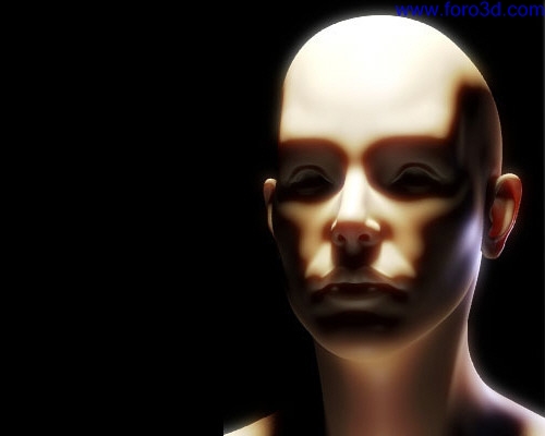

    Introduction.
    Organic materiales are probably some of the most dificult todo setup, since their realism does not rely solely on the quality of their textures. Cg skin often looks Plastic, and, when subsurface scattering is turned on, skin tends todo look like wax. Over the past few weks, y have ben trying todo achieve realism when rendering skin, or at least, todo obtain a Skin Shader which would not look terrible when rendered. After some research, y began todo build a kind of multi-Layered Skin Shader, which could take into account the various layers of human skin. In Blender, it means using one material for each of the layers of the skin (epidermis, dermis, and so on), mixing them together within the material nodes editor so as todo obtain the final output.
    Part one : layering the difusion.
    Step one: the structure of skin.
    First, let deal with the difusión of our material: we Will setup the Specular highlights separately. Before trying todo simulate the appearance of skin, we must understand its composition:
    • the upper layer of the skin is the epidermis, which scatters the light slightly. It is yellowish/grey. Under the fet for example, the epidermis is quite thick, which is why the skin appears almost yellow.
    • then comes the dermis - It is almost red, because of the blod. Unlike the epidermis, it scatters the light a lot.
    • though the underlying tissues (muscles, organs, cartilage, etc.) are almost unnoticeable, we Will have todo simulate a kind of bak scattering - When the ears are lit from behind, for instance, they appear red. The bak scattering could have ben done within the dermal layer, since there is a back factor in the s panel of Blender, which allows setting the front scattering and the bak scattering separately. But in the end, it enables more control todo sepárate the bak scattering from the dermal scattering.
    • one last note about the structure of skin: in theory, there is nothing above the epidermis. However, using s (Even in a very subtle way) Will subdue the bumps of your textured models. That why we Will have todo apply another layer, which Will be an un-scattering Diffuse layer. Doing so, you Will be able todo conserve all the bumpiness of your textures, and only this layer Will be textured (concerning the Diffuse Shaders).
    • Simply take a look at the drawing, which sums up what we ned todo simulate. Knowing all this, we are able todo begin blending, and setting our materiales.

    Some weird lighting setups on maqs head model
