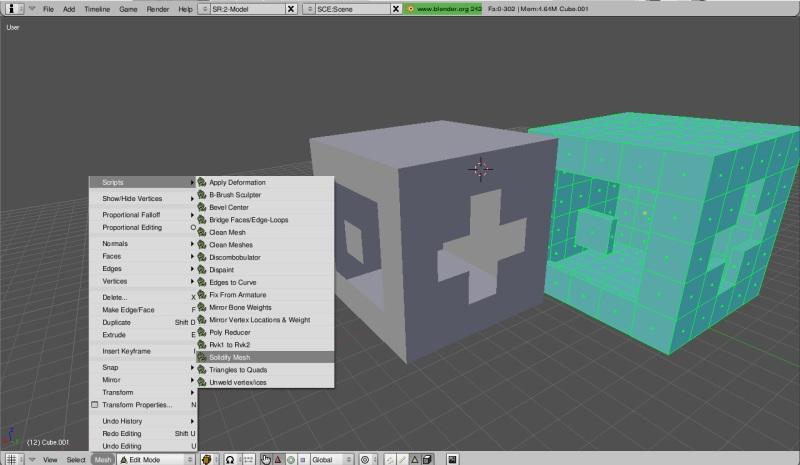

    (Campbell Barton) 2006/09/20 04:43:09 cest]. Added files: Blender/release/scripts mesh_solidify, py. Log:
    Update and add a new script -.
    Makes the Mesh solid by creating a second skin of a set width.
    Works with UV and vertex col but not weights at the moment.
    Es utilísimo.
