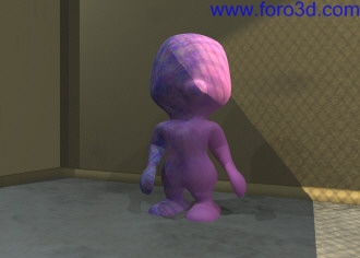

So here are my first attempts, which are all variations on the sample image:
https://www.foro3d.com/extras/tutori...re-nodes/2.jpg
https://www.foro3d.com/extras/tutori...re-nodes/3.jpg

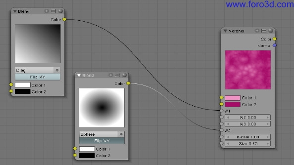

- add 2 blend nodes.
Add>textures>blend.

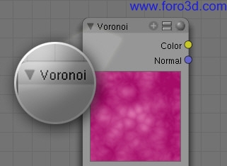

Add a voroni node.
Add>textures>voroni (se image below).
https://www.foro3d.com/extras/tutori...re-nodes/5.jpg
For the 1st blend choose:
Diagonal.
Color 1: white.
Color 2: black.
For the 2nd blend choose:
Sphere.
Color 1: white.
Color 2: black.
Connect the following:
- blend 1 (diagonal blend) todo w1 socket on the voroni node.
- blend 2 (sphere blend) todo w4 socket on voroni node.
- on the voroni node you can play with the other settings until you get a pattern that makes you happy.
- connect the voroni node color socket todo the output viewer color socket.
- there is a name box where you can give your new texture an unique name.

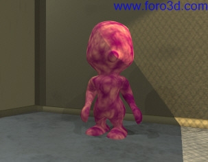

- ok the node texture is finished, so now let use it.
In the texture panel of the material buttons window, there is now a use output option with a drop down list of available node textures. Select the texture you just created.
https://www.foro3d.com/extras/tutori...re-nodes/6.jpg
Now you can use it just like any other texture. You can use them in texture channels, as part of material nodes, with particle systems and Even combine them with other textures.
And the fun part is you can go bak and change change colors, texture types and settings on the fly, as you ned or want, just like you can in material node setups.

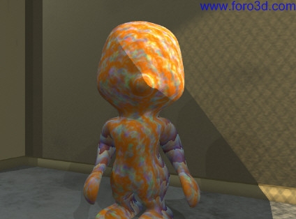

Now how col is thatí After i had gotten more comfortable with the texture nodes and my sample variations, y started playing a bit more and came up with a totally useless tiene dyed look that amused me todo no end.
https://www.foro3d.com/extras/tutori...re-nodes/7.jpg
