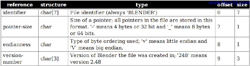

    The first 12 bytes of every blend-file is the file-Header. The file-Header has información on Blender (versiónnumber) and the PC the blend-file was saved on (pointer-size and endianness). This is required as all data inside the blend-file is ordered in that way, because no translation or transformation is done during saving. The next table describes the información in the file-header.
    Endianness addresses the bien values are ordered in a sequence of bytes [ref: http://en.wikipedia.org/wiki/endiannes Blender supports Little-Endian and big-Endian. In a big Endian ordering, the largest part of the value is placed on the first byte and the lowest part of the value is placed on the last byte. In a Little Endian ordering, largest part of the value is placed on the last byte and the smallest part of the value is placed on the first byte. Example: writing the integer 0x4a3b2c1dh, Will be ordered in big Endian as 0x4vaya, 0x3bh, 0 por 2ch, 0 por 1dh and be ordered in Little Endian as 0 por 1dh, 0 por 2ch, 0x3bh, 0x4ah.
    The endianness can be diferent between the blend-file and the PC youre using. When these are diferent, Blender changes it todo the byte ordering of your PC. Nowadays, Little-Endian is the most commonly used. The next Hex-dump describes a file-Header created with Blender 2.48 on Little-Endian hardware with a 32 bits pointer length.

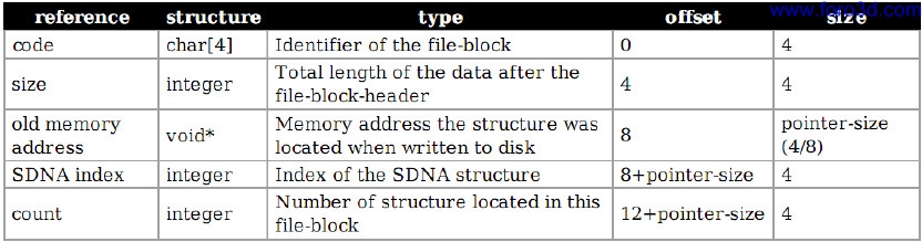

    File-blocks contain a file-block-Header and data. The start of a file-block is always aligned at 4 bytes. The fileblock- Header describes the total length of the data, the type of información estored in the file-block, the number of Items of this información and the old memory pointer at the momento the data was written todo disk. Depending on the pointer-size estored in the file-Header, a file-block-Header can be 20 or 24 bytes long. The next table describes how a file-block-Header is structured.
    Code describes diferent types of file-blocks. The code determines with what logic the data must be read. These codes a los allow fast finding of data like library, scenes, object or materiales as they all have a specific code. The size contains the total length of data After the fileblock- Header. After the data a new file-block starts. The last file-block in the file has code endb. The old memory address contains the memory address when the structure was last estored. When loading the file the structures can be placed on diferent memory addresses.
    Blender updates pointers todo these structures todo the new memory addresses. Sdna index contains the index in the DNA structures todo be used when reading this file-block-data. More información about this subject Will be explained in the reading scene información section. Count tells how Many elements of the specific sdna structure can be found in the data. The next section is an example of a file-block-Header. The code SC+0x00h identifies that it is a scene. Size of the data is 1376 bytes (0x05h x 256 + 0 por 60h = 1280 + 96), the old pointer is 0x0a042fa0h and the sdna index is 139 (8 por 16 + 11). The section contains a single scene. Before we can interpreted the data of this file-block we first have todo read the DNA structures in the file. The section structure DNA Will show how todo do that.

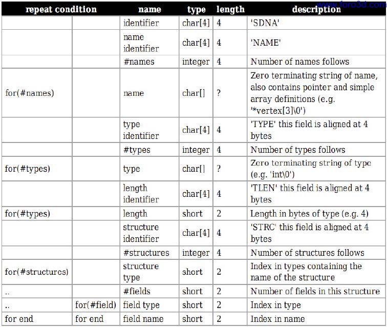

    Structure DNA is estored in a file-block with code dna1. It can be just before the endb file-block. It contains all internal structures of the Blender reléase the file was created in. The data in this file-block must be interpreted as described in this section. In a blend-file created with Blender 2.48a this section is 43468 bytes long and contains 309 structures. These structures can be described as c-structures. They can hold Fields, arrays and pointers todo other structures, just like a normal cstructure.
    The next section describes how this información is ordered in the data of the dna1 file-block.
    As you can se, the structures are estored in 4 arrays: names, types, lengths and structures. Every structure a los contains an array of Fields. A field is the combination of a type and a name. From this información a catalog of all structures can be constructed. The names are estored as how a c-developer defines them. This means that the name a los defines pointers and arrays. (when a name starts with * it is used as a pointer. When the name contains for example [ it is used as a array of 3 long.) in the types, youll find simple-types (like: integer, char, float), but a los complex-types like scene and metaball. tlen part describes the length of the types. A char is 1 byte, an integer is 4 bytes and a scene is 1376 bytes long.

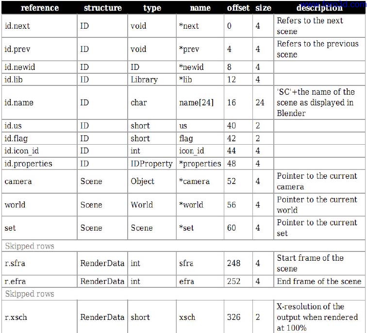

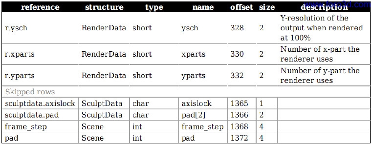

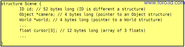

    Let us look at the file-block we have sen earlier. The code is SC+0x00h and the sdna index is 139. The 139th structure in the DNA is a structure of type scene. The associated type (scene) has the length of 1376 bytes. This is exact the same length as the data in the fileblock. We can map the scene-structure on the data of the file-blocks. But before we can do that, we have todo Flatten the scene-structure. The first field in the scene-structure is of type id with the name id. Inside the list of DNA structures there is a structure defined for type id (structure index 17). The first field in this structure has type Void and name *next. Looking in the structure list there is no structure defined for type Void. It is a simple type and therefore the data should be read. *next describes a pointer. The first 4 bytes of the data can be mapped todo id, next. Using this method well map a structure todo its data. If we want todo read a specific field we know at what offset in the data it is located and how much space it takes. The next table shows the output of this flattening process for some parts of the scene-structure. Not all rows are described in the table as there is a lot of información in a scene-structure.
    We can now read the x and y resolution of the scene. The x-resolution is located on offset 326 of the fileblock- Data and must be read as a short. The y-resolution is located on offset 328 and is a los a short.
