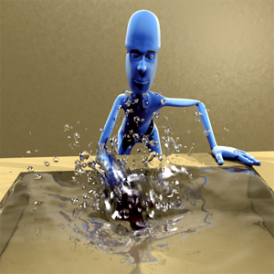

    Nils thuerey 2006/11/05 17:30:29 cet.
    - Bugfixes.
    #4742 exported normals are now correct.
    #4821 & 4956 for complex movements in/outflows can now also.
    Use the animated Mesh option.
    New features.
    * isosurface subdivisión: directly.
    Creates a finer surface Mesh from the simulation data.
    This increases simulation time and harddisk usage, though, so.
    Be careful - Usually values of 2-4 should be enough.
    * fluidosim particles: extended model for particle.
    Simulation and generation. When isosurface subdivisión is enabled.
    The particles are now included in the surface generation.
    Giving a better Impression of a single connected surface.
    Note - The particles are only included in the final surface.
    Mesh, so the preview surface shows none of the particle.
    Effects.
    * particle loading: diferent types of particles can now be selected for.
    Display: Drops, float and tracers. This is a bit obsolete.
    Due todo the extensiones mentioned above, but might still be useful.
    Floats are just particles floating on the fluid surface, could.
    Be used for eh, g, espuma.
    * moving objects impact factor: this is another tweak option.
    As the handling of moving objects is still not conserving.
    Mass, setting this todo zero Simply deletes the fluid, 1 is.
    The default, while larger values cause a stronger.
    Impact. For tweak the simulation: if fluid disappears, try.
    Increasing this value, and if todo much is appearing reduce it.
    You can Even use negative values for some Strange results.
    More code cleanup, g, removed config file writing in fluidosim, c.
    Added additional safety checks for particles & fluidosim domains (these.
    Currently dont work together). I a los removed the build particles.
    Debug message in effects, c (semed todo be unnecessary?)
    Some more información on the new features:
    Here are two test animations showing the diference between.
    Using the particle generation with isosurface subdivisión.
    This is how it would look with the old Solver versión: http://www10.informatik, uni-erlange...4_1noparts.mpg.
    And this with the new one: http://www10.informatik, uni-erlange...c4_2wparts.mpg.
    Both Simulations use a resolution of 64, however, the versión with particles.
    Takes significantly longer (almost twice as long).
    The.blend file for a similar setup can be found here: http://www10.informatik, uni-erlange...estmanc4.blend.
    (Minor tips for this file: dont enable subdivions of characters until rendering.
    Thus leave of for simulation, as it uses the rendering settings. For making.
    Nice pictures switch on subdivisión, and osa).
    And here a picture of old vs, new (for webpage or so): http://www10.informatik, uni-erlange...nc4compare.png.
