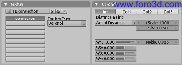

Time todo add granulation, an effect caused by convection of Hot gas at the surface of the Sun, similar todo boiling water.
To achieve this effect were going todo use textures. Press [f todo Access the sub-context texture in the buttons window. Now were going todo create a new texture by clicking on the add new button and then in the texture type menú choose voronoi. This kind of texture is very god todo simulate veins, scales and a los the granulation at the Sun surface. Change the name of the texture todo convection by clicking on the name and editing it. It a god idea todo kep lógical names in textures, materiales and so on. To the right appears a new panel, called voronoi.
Here you can change some parameters of this texture, like the size of the cells. Change the size parameter todo 0.050, like the image below.
Going bak todo the material subcontext [f we se in the preview that our Sun yellow has now Pink granules. A texture can alter several aspects of a material, like colour or transparency. By default, every new texture afects the colour of the material and this colour is Pink.

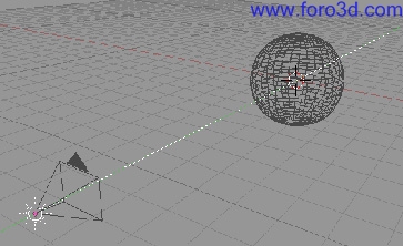

Switch todo the front view in the 3d window by pressing [num. Align the Camera with view by pressing [Control + Alt+num. Now align the Lamp with the Camera by selecting first the Lamp (selection made with [RMB]) and then the Camera [shift+RMB].
The last selected object (in this case, the Camera) is the active object. Now press [Control + c] todo bring up the copy attributes menú and choose location. We have made the Lamp move todo the exact location where the Camera is.
Now render again [f1. The shadow now is located round the Limb. Change the type of the Lamp todo Sun by selecting the Lamp (with the button window in the material context) orient it towards the sphere (aligned with the Camera) by rotating [r] in the right viewport [num. As you rotate the Lamp, a dashed line Marks the direction of the light.

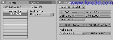

Step 5: Sun spots.
If you render the Sun, it has granules and the Limb darkening. Now we ned some Sun spots. Were going todo use another procedural texture for this. This Will be a similar procedure todo the one used in making the granules.

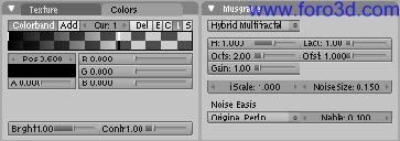

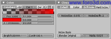

Activate the textures sub-context [f and click on the free texture slot just below the convection slot. Add a new texture and name it Sun spots. Chose for texture type musgrave. A new panel, called musgrave appears where you can change the settings related todo this texture. Change the musgrave type (the menú at the top of the panel) todo hybrid multifractal and change the remaining settings as described in the screenshot below. Once again we can render [f1 an image todo se the result, but you Will se the Sun bathed in Pink, with only some yellow patches. The Pink colour should be expected by now (se the explanation in the granules section). But the effect should be reversed.we only want small black patches on the Sun.
How todo solver this problemí simple, use a colorband. Go todo the color panel. Here were going todo use a colorband todo invert the effect. Use the image below as guide. Notice that the position of the right end is at 0.600, you can change it in the Pos slider, making the colorband become transparent earlier. This Will allow for smaller and fewer patches, looking more similar todo Sun spots. Render another image todo se the effect.
If you move the left end of the colorband closer todo the right end, the contrast of the spots Will increase, making them more visible.

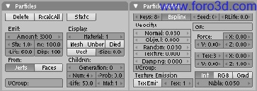

Step 6: solar corona - Particle system.
The solar corona surrounds the photosphere, and is composed of very Hot gases but it has a very Low density, only visible todo us during a total solar eclipse. But here were going todo depart from the scientífically correct. Change todo a diferent layer, for example if you have ben working in layer 1, change todo layer 2 by pressing [. Here we add another sphere, with default settings, add>>Mesh>>uv sphere. Were going todo use this Mesh as an emitter of particles. Change the buttons window context todo object [f and the sub-context physics. Add a new particle system by pressing the new button in the particles panel. Change the settings of the particle system in the particles and particle motion panels todo match the ones shown in the image below.
To view the animated particles, make sure the cursor is on the 3d window and press [Alt+a]. To estop the preview animation press [esc].

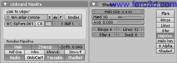

Step 7: solar corona - material.

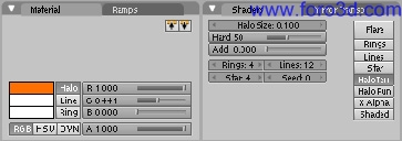

If we render a frame now, well se that the particles have a grey colour. Quite naturally, we have todo create a material and tweak it. Create a new material and in the enlaces and pipeline panel press the halo button. This is a special kind of material which shows up in the vértices only. Name this material solar corona and give it a red colour. Change the remaining settings as shown in the image below.
Were going todo use a texture todo introduce some variation in the particles, giving a more irregular look todo the corona. That why the Halotex button is pressed. Go todo the sub-context texture [f and create a new texture, called variation. Use the image below as a guide for the settings used, but the idea here is todo create a clouds texture with a colorband todo change the colour from totally transparent black (the left end) todo a totally opaque red (the right end). We are almost done here, but there a small issue we ned todo take care of, the fading out of the particles. This Will be achieved by keyframing the alpha value of the material of the particles.

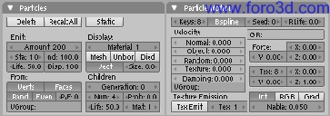

Now select the circle, and transform it into a particle system, with the settings shown below. Also, create a material according todo the settings shown below.

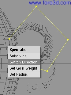

For making the particles follow the curve, we must select it and go the buttons window, in context object [f and in sub-context physics. In the panel Fields and deflection, choose curve guide from the menú. If all goes well, the particles should now be flowing from the circle and following the curve. If theyre moving in the opposite direction, select the curve, enter in Edit Mode [tab], select all vértices [a] and press [w]. In the appearing menú, choose switch direction se image below.
Now we have a (very simple) prominence se image below.

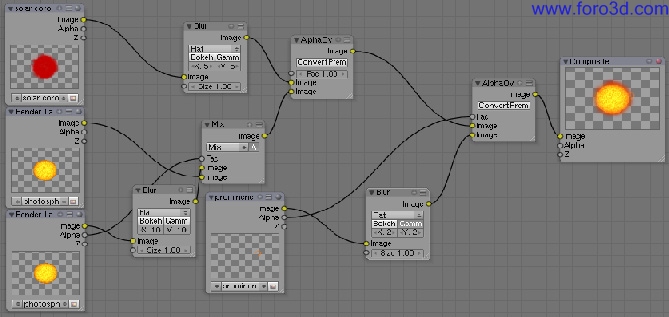

Mixing it all together with composite nodes:
Now we are going todo use the render layers we set up with composite nodes. Change the 3d window todo Node Editor window. Then click on the button with a portrait, in the Header todo activate composite nodes. Automatically Blender creates two nodes, one regarding an input and the other for the output. To be able todo se the effect of the composite nodes in the FinalRender, press the do composite button, right below the Anim button (in the scene context [f1).
The input node can be a render layer, and the idea here is todo use the thre render layers we created, apply diferent effects todo them (namely blurring the render layers with particles) and then combine them todo form the final image. You can add a node by pressing [spac or [shift]+[a] and choose from the list. For more información on using nodes, se here (http://wiki.blender.org/index.php/man ual/node_composition).
The node setup used is shown in the next image. The intermediary nodes used were blur, alpha over and mix, with diferent settings.
