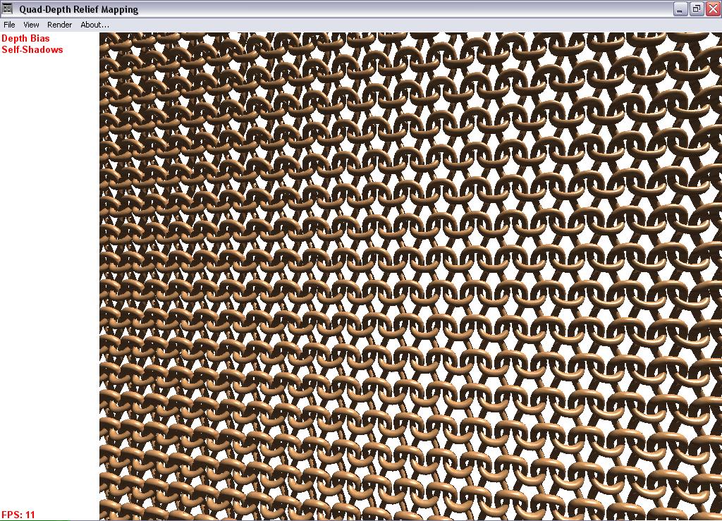

    Excepto en esta demo (si pongo Tile factor = 10) que saco 11 fps. https://www.foro3d.com/attachment.ph...id=30962&stc=1.
